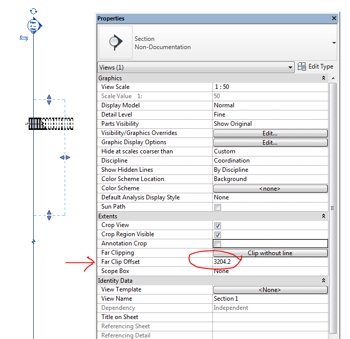

I have a structural Revit model linked into my Revit architecture model (structural model is attached not overlaid). If I cut a section in certain direction the linked Revit Structure model doesn't show up. If I flip the section it appears. It happens all the time with the linked model never showing up no matter what the settings are, yet appears as soon as the section cut is flipped. Is this a glitch that can be repaired with a patch? I am well versed in Revit usage and it is not a setting issue I assure you. with the same settings it appears in the opposite direction. I have upload an example to examine.

Hi Dan. Have you considered checking the properties of your Section and the "Far Clip Offset" setting? Maybe the value you placed there is too small that when you flipped your Section the view clip can't see beyond - in this case an opening (I suppose?). Try changing the offset value with a bigger number and see if that works.

In the Depth Clipping box of the element properties use clipping without line and everything will show up. For some reason when you use Clipping with Line in certain directions the link will not appear. Gauranteed to work.

Clip without line did it. Thanks.
