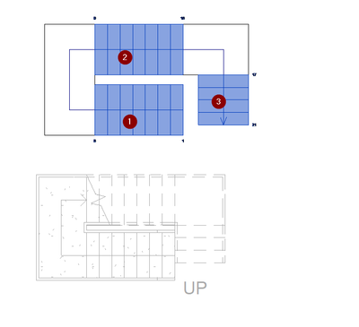

here the boundary joined is the problem, which I have marked in image.  it's not allowing me to join the boundary but I need to add one riser at the end, what can be done?
I tried moving the boundary line as shown in 2nd image and it worked but I want to create the step in straight line and when straight line is created it gives error.

Draw using "Run" in Stairs.
then each flight you can customize.
As of now the boundaries are overlapping which is not
allowing you to create that particular flight.
Don't need to sketch. This is a simple 4-run 3-landing stair.
