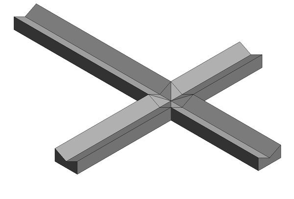

I need to draw this intersection without the circled part in blue, that is, a T-shaped intersection. Until then it was designed with a metric profile family, when together the points form a unilateral corner.divisa canaleta1.PNG

Looks like you are trying to "blend" two concave shapes together.  Cut away the "excess" with a Void or two.   Post the file. Lets take a look at it.

I cannot post the project file, but I send the file with the specific part.
I didn't understand what VOID would be. Was it the molding of a void on the spot?

Create In-Place Component Voids to cut away the overlapping geometry.  Are you familiar with how to do that?
BTW, are these Slab Edges suppose to be Cable Trays?  Just curious.

if that's what I'm thinking, I modeled it on the spot as a vacuum extrusion and it didn't work. As you did? could you send me the file please? This structure is for rainwater drainage, but the concept you mentioned is similar.

The two In-Place Component Voids are named "Generic Models bb1" and "Generic Models bb2". They are under the Generic Model Category in the Project Browser.

2019 attached.
BTW: Void Sweeps were created using "Canaleta(bb)" Profile Family.

I got it because of your help. Thank you!
