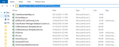

Hello Reviter,
How does it work with the interoperbility-tools!?
i want to IFCclassify my elements, but i have no default xml-list to modify.
Can anybody give me an advice?
where can i find this .xml and how can i modify it?
KR
Andreas

By default if not moved to another location they can be found in the following directory
C:\Program Files (x86)\Autodesk\BIT\2022\Resources
More on the how to you can find on the following links
https://www.youtube.com/watch?v=Ya6J4Iqf6lo
https://interoperability.autodesk.com/classificationmanager.php
https://bim-me-up.com/klassifizierungsmanager-fur-revit/

Ok i found it but there is no .xml regarding IFC classification?
Or have i to use the Classification Manager Database Custom? and how to costumise it?
Does the ifcClassification also work for the TypeEnumeration ?
f.e.:  IfcFurniture.SHELF ... CHAIR ... TABLE ...
I checked it ! it does not work! how can the tool say "i do it" and finally nothing happend!

The folder is emty! in my case!
Can you publish this XML? or do you have a download-link?
KR
Andreas
@Andreasdraxl
If the files are missing then they have been either moved or it is a bad installation...best would be to remove the BIT tool and reinstall
the database is an xlsx not xml...It is also attached below...Link to the database download should be also found in previous reply and link also highlighted below

Thank you, i got an answer from autodesk! inspite of all tools. Autodesk Revit is not supporting the TypeEnumuration of IFC4 ...
