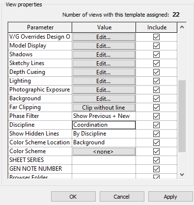

Hello everyone,
Has anyone experienced an issue with interiors showing through an exterior elevation in Revit? See Image attached.
This is in Hidden Line view (not wireframe) using the typical components. Even if a new elevation is taken, the same results.
Looked at View Templates, Design Options, redrawing the wall but everything looks right.
Any ideas will be helpful. Thanks!

Message 2 of 19
constantin.stroescu
Check if you haven't :
  • an Override for Category or Element for that Exterior Wall
  • a View Template that saves the transparency settings
  • or even if the Object Style >Walls has not a Material with Transparency ...is this visible in a 3d View too?

TripleM-Dev.net
Maybe there's a Filter active on the viewtemplate making the wall transparent or even the whole category.
Or the "show hidden lines" property of the view set to All?
I take it the interior is modelled and not a dwg placed in view?
Post a screenshot of the view's properties or maybe share the file/or part of it.
- Michel

Message 15 of 19
This is how it looks. Let me know if anything needs to be changed.
Also, it is not just an issue of Plumbing components showing up. I can see some interior walls, Case works and a lot of other interior elements as well in different elevations. Thank you.

Message 18 of 19
constantin.stroescu
maybe you have the transparency setting in Graphic Display Option
Constantin Stroescu
Message 19 of 19
This works! Thank you so much for your help.
