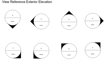

I've read a couple of similar posts but not with this exact issue. I'm trying to create a one way internal elevation marker where the pointer rotates/moves as standard, but the reference sheet and detail number labels in the body stay put. I need the detail number inside the body, and only one ticked pointer per marker so it suits angled walls.
I've been able to get it to work for 90 degree angle views by adding extra pointers, but it doesn't work on angled walls, as shown in the screenshot attached. I added 45 degree pointers as well just to test it, but obviously that didn't work. I just want the labels to stay at horizontal and centred. I tried locking, pinning, and ticking and un-ticking all the property boxes but nothing has worked yet.

It cannot be done with out of the box elevation tags. However you can replace it with view reference. See attached

Go to view and you click on the View reference icon
Choose the symbol and then reference to your elevation
