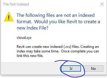

@Viveka_CD and @Anonymous, this is my example for "XYZ" FILES
-In this case the company brought me a file with this format "cloud.xyz" , so I started with Revit 2017 and I went to "INSERT" tab, panel " LINK"  and then i clicked in the tool "POINT CLOUD"
-Then appears this window and click open.
-In the next step appears a windows showing this sentence " The following files are not indexed format. So that window allow you to creat an rcs. file. Then click "YES"
-In the next and the last window the program will show  you in what kind of unit you want to work the file, so in my case I choosed "Meters" and then I click " START INDEXING"
- Next go to "INSERT"  tab, click on "POINT CLOUD" tool,  select the "RCP" file and
click open. Select a 3D view and that's all. 😃
Please select the Accept as Solution button if my post solves your issue or answers your question. Likes welcome!
