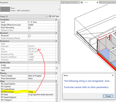

I would like to know how is possible to link in an instance parameter a formula which cointains the dimension data of the object, as the example below:
Instance parameter: 001.Misurazione  = Area (Dimensions) * 2
in this way if I change the dimension of the floor my 001.Misurazione parameter will update automatically
Thanks in advance

No; not in the Properties of the Element.  But you could do it in a Schedule via a Calculated Parameter.
