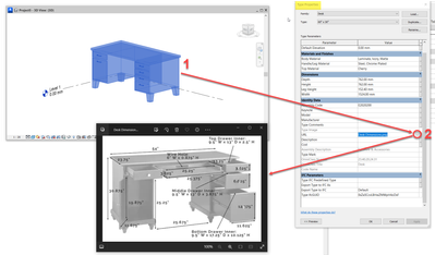

How about a link to the Image? Open one of the Sample Projects in pre-2024 Revit and see how they have associated the "Help Button" to a "Learning Link".

I don't know what the issue could be. You just type in an address. No different that entering an address in a web browser.  As for how to add it to your own Project, just copy the one in the Sample File to Clipboard and Paste it from the Clipboard into your Project. CTRL-C, CTRL-V.  Bada bing.
Nachricht 5 von 15
als Antwort auf: Zeeshan_Abbasi
BTW: you don't even need to type in a full address. Load all the images into your Project and then just type the Image Name.  For example: "Smiley.png" like I showed in my screenshot.

What would a Dynamo Routine do?  It's fundamentally 2 steps. Select the element you want to inquire about and then select one of its properties, such as its URL Type Property.
