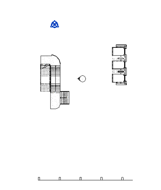

Hi!
I am working in Revit 2019. I inserted a new level (3) between level 2 and 4, but components that should be cutting through are not visible. I have and elevator that goes from the 1st floor up to the 11th floor. It shows up fine-along with other walls on the other levels, but not on level 3. I know I should've insterted the floors in order, but for some reason I didn't think I needed it (I know-duh!). From the 2nd level to the 11th is an atrium, so I should be able to see the stairs I inserted from the 2nd to the 4th floor. Again, they show up just fine on level 2 and 4, but nothing on 3. What am I doing wrong? I even tried removing the linked CAD, and linking it again, but that didn't work either. HELP!
Thanks in advance!

Did you actually create a Plan View for Level 3 through View=>Plan Views=>Floor Plan?
What are the View Range settings?
Can you post the file?

I tried creating a plan view, but level 3 isn't an option.

Not sure what you are missing in the View. This is what I'm seeing in Project Completion Phase (Import Categories hidden).
edit...sorry, this is what I'm seeing. It's everything that's on Level 3

It must be my view range or visibility graphics or something??? I haven't started tracing anything on level 3 yet because I couldn't see anything. Do you mind telling me what your visibility properties are set to? Maybe that will help. I've changed mine all over the place. I'm sure it's probably one click somewhere.

All Model Categories and Subcategories are turned on.  Imported Categories turned off.

It was the Phase!! I can see everything now! Thank you so much!!!:Strebergesicht:
