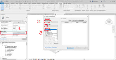

Why are all the options greyed out? Can't work with none of themScreenshot_10.png

You have a view template applied, set it to <none>.

Thank you very much! Just one additional for anyone that might need this topic: I had to set the view filter and the discipline filter for "all" in order to set "none"
