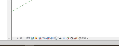

Hi All,
I am facing one problem in Revit . I added one texture to material but not showing the 3d view and Render. Every where it shows as color. I need texture to see in the 3d image and also to see in the render time. I am using 2018 Revit
please see the attached images for more information
Materials showing with the texture
3d image showing the without texture
see the bottom panel
362 Views
I can't tell anything from that screenshot.  It's shaded and too far away.  But maybe the tile is too small. Enlarge it through the Texture Editor.  Know how?
syman2000
Convert the TIF to JPG or PNG and see if the issue still persist.
FWIW, @deepu_abraham, you can enlarge the thumbnail preview....
The texture scale is very small because it is what it is - the texture of a sheetrock material.  You could enlarge the texture image scale but it would be an incorrect presentation of the material.  I don't think is necessary to change anything personally.
p/s: if you zoom in very close then you can see the texture, or create a small element and render it.
