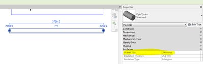

Radish_G
als Antwort auf: Anonymous
Hi @Anonymous,
Thanks for your reply.
Are we able to do it for the System Family Parameters?
Pipe Family...,
Regards
Radish G

Radish_G
Hi @Anonymous ,
What I mean is, how to find the type of the existing parameters.
In this case, how to find the type of the "Overall Size" parameter of Pipe Insulation.
Regards
Radish G
Nachricht 14 von 15
als Antwort auf: Radish_G
If you edit the parameter you can see the type - it will be greyed out though, as it cannot be changed.  If you need a different one you will need to create a new one.
Nachricht 15 von 15
Radish_G
Hi @Anonymous,
This is the place where I am stuck with.
May I have a screenshot of it?
Regards
