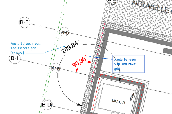

Hello everyone,
My problem is that when i import a CAD file into Revit, the CAD file gets distorted.
  • Difference between CAD grids and revit grids appears even when i created grids from same cad file .ihiTLSDD_0-1636015767485.png
  • Difference in angle
  • Did anyone faced this problem can help me ?

@ihiTLSDD
  1. How far is the cad file from the internal origin
  2. Has the CAD been properly aligned?
  3. Switch the Revit Grid off and measure the angle between the cad grid and cad wall, is it accurate?
Would you be able to attach the CAD file?

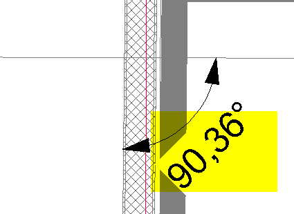

CAD file is aligned ,the problem when i insert it into revit ,This is the angle between wall and CAD grids .

@ihiTLSDD
When the above is the first thing to pop up when trying to link/import a cad then it is either of 2 things
  1. The CAD file has elements flying around away from the origin (0,0,0) and need to be cleaned up
  2. OR the CAD file is georeferenced with respect to 0,0,0 (instead of a local bench mark station. And the Revit model need to acquire coordinates and establish shared coordinates
Open the cad file and check the following XREF at 0,0,0

I've already sent you the origin CAD file but I've already done these things but still the same problem.

@ihiTLSDD
The CAD you sent is the file I captured the screenshots from...download and open it then zoom extent. you will see that there are elements way more than 20miles apart

I've look at your file and it is beyond your origin point. This is why you have line jittering. Also for angle, Revit will always look for shortest angle. In CAD you can control what you want as angle but it makes no sense since builder will want the closest angle possible.
