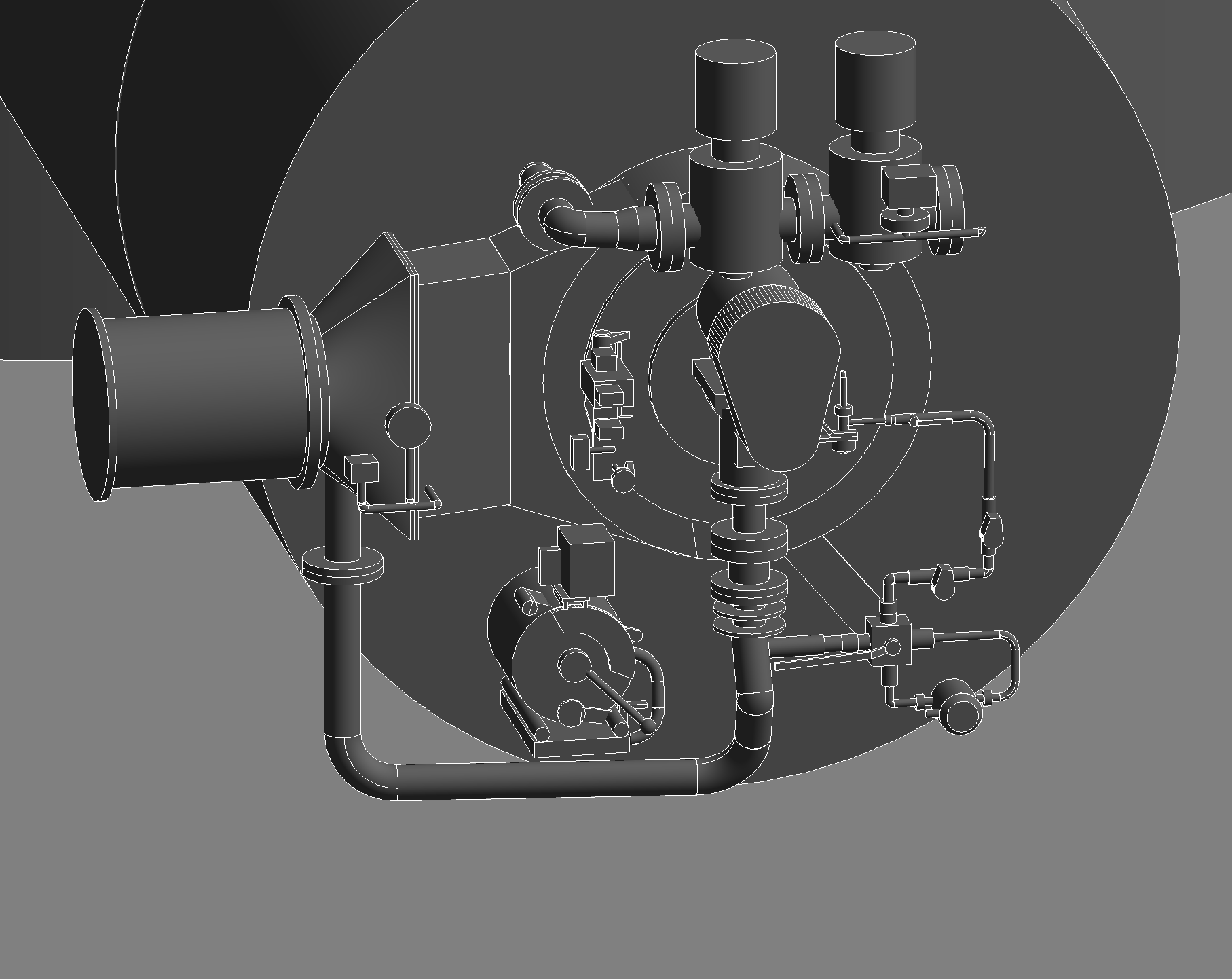

i have some problem, when i try to import 3D-DWG into Revit Family.
some of the shape are not showing properly in Revit. (see Attachment)
Can some one help me pls?
Thanks in advance!

Have You tried exporting object(s) to SAT file and import it to Revit ?
Can You post mentioned dwg file ?

gostia
actually i have met this problem many times in my other DWG drawing. And i have already tried that solution. But i feel this solution not good enough, because every time i export my DWG to SAT file, there will be a warning that said, the export is succesfull exporting "E.g. 400 from 800 Objects". Looks like every time there will be a missing object when i export from DWG into SAT file. And again when i try to link this SAT file into Revit, revit will give me another warning, that said some of the object can not be shown properly. So as the result maybe from 800 Objects, i will only got around 200 Objects. That is why i want to know the other solution. by the way, i also have tried exporting into IFC.
but again in IFC i got another problem, some wall penetration not showing correctly.
thats why i want to know, if there are any other solution for importing DWG file into Revit.
you can find my DWG in attachment.
Thanks in advance!

Hi @gostia
As far as I can see , using sat these 3 parts are missing in Revit:
I am sorry.
BTW , I used Fusion 360 to generate sat file
Rafal Gaweda

Hi @Rafal.Gaweda ,
thanks for your effort. Yeah, somehow there are something not correct in Revit import.
Because at first i thought, it must be because of some complicated shape that really hard to convert, but sometimes even normal cylinder also missing.
thanks a lot by the way, lets see if other people have any other solution for this.
Because i have also tried so many different way to import them inside revit. also with other model. but looks like this problem keep coming.

Hi @Rafal.Gaweda
Thanks a lot, really nice.
Can i have another question, i tried to import your SAT file into my Revit.
But it shows different with yours. My model is becoming like this. The missing part at my modell is at the top. and the bottom part not missing.
btw can you tell me, how can i show the model with color like yours?
thanks in advance!

Hi @gostia
I "Imported CAD".
It seems you "Linked CAD" because You have these missing elbows (I know, I see top "deck" is not correct.)
Rafal Gaweda

Hi @Rafal.Gaweda
yes you are right, i linked it just now and when i tried "import", it is the same like yours now.
i thought, it is the same, if i use "link" or "import". this really surprise me.
thanks for another lesson.
