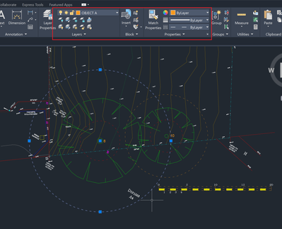

My CAD lines showing up solid, that's fine as I need to go to Object Style and override them, if I do this I expect to see them broken just with this procedure surely?
but they still don't show up broken so I have to do it with VG overrides, then it works when I override it, for me no biggy but if I had multiple sheets with the CAD insert surely overriding through the project with Object Style? rather than sheet by sheet??
what am I missing?

Upload the sample DWG so we can look at some other factor in the DWG that may be overlooked.
Nachricht 9 von 12
wisedrawing
als Antwort auf: wisedrawing
Heres a bare bones with the TEST 1 .Dwg file and a changed the SRZ red layer and the OBJECT A line (the big circle)
no change on screen (that would work if I VGed it
cheers
Nachricht 10 von 12
syman2000
I've look at the DWG file. Apparently a lot of the objects have override color, linetype, lineweight and linetype scale. Typically Revit will only read DWG file with only bylayer setting and not override.
I did a quick cleanup to make the override object set to by layer.
When linking in the Revit file, you will notice the linetype start appearing. See attached

you know as I was uploading it I thought I bet there is some legacy in my CAD files. That template is 30 years of building up imported surveys and layers until I started using Revit and just never spent the time cleaning it up
excellent, I think I need to spend the time on that now. I kept thinking I need to clean this up more than just purge command
FYI they often come heavily loaded from the survey CAD so I will need to work on that
