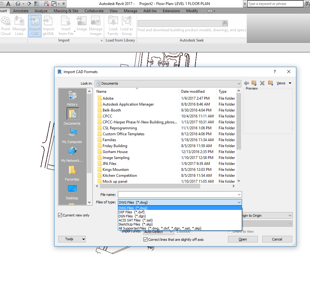

When attempting to import a rhino file into revit using import CAD - the .3DM / Rhino option isn't listed... What am I missing here?

I have not imported anything yet- I'm just saying the OPTION to select .3dm files (rhino files) is not displayed...
It shows up here.

Yes, haha. I understand it should be in the dropdown.. It is not there though..
Image below:
Update Revit to the latest service pack. I think the version should be
2017.1.1.
