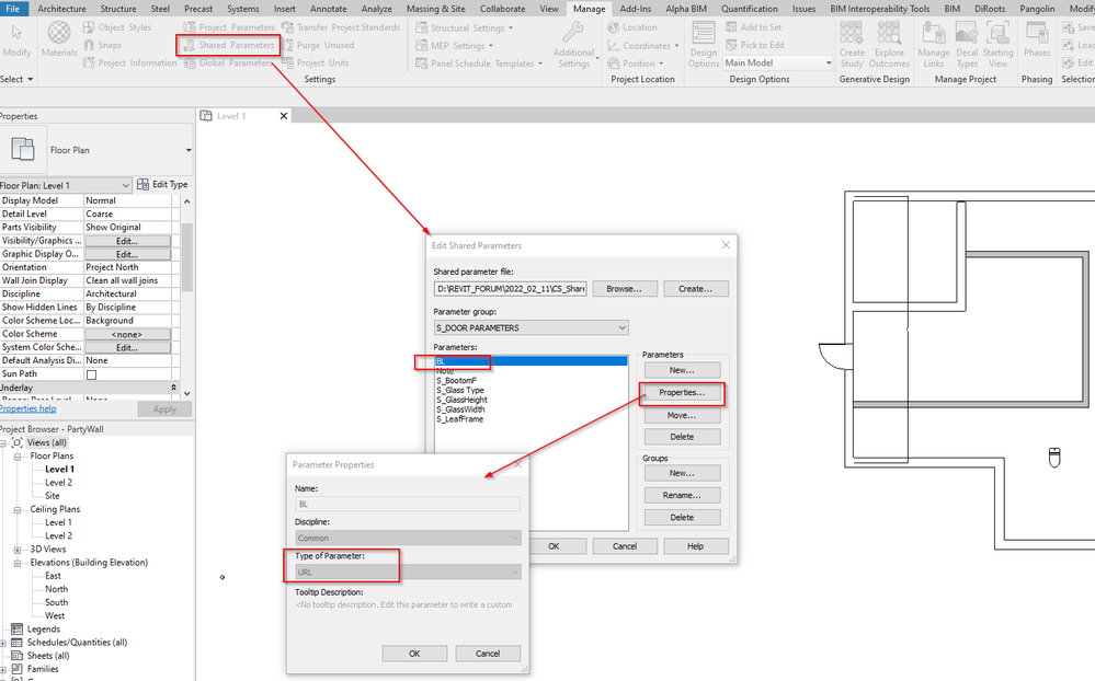

If you want to create only a hyperlink from a Revit Element to an other document, then proceed similar with the : URL parameter:
  • first, be sure the document you want to refer to is placed in a Cloud Base Storage ( Google Drive for instance)
  • In Revit create a new Shared Parameter  - Type of Parameter: URL and then add it to Project Parameter assigning it to desired Categories
  • open in Google Drive the File that contains the document and right click on it : choose Get Link , then Copy Link and Done
  • back in Revit , paste the Copy Link into Parameter value
Constantin Stroescu
