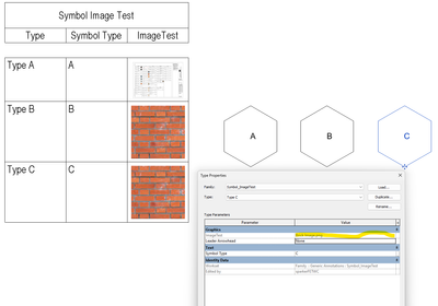

Ok I just learned I can add these pictures in to the types in the family editor but not in the project. In the example below I created A and B in the family but duplicated B and created C in the project. C adopted B's image and is uneditabble in the project. Kind of a weird limitation. Not one I've seen. I don't think this will work in practice with a multi person team.
