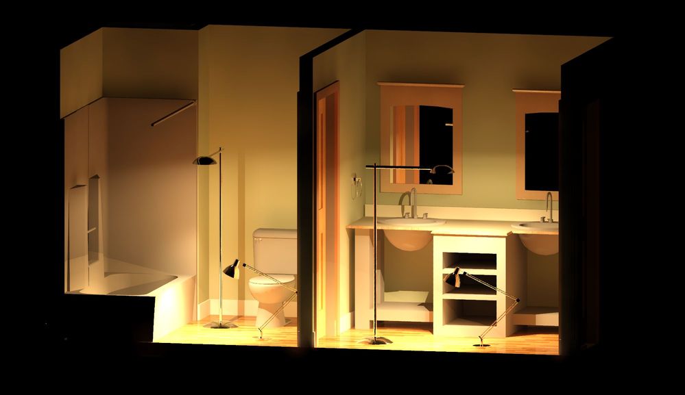

When trying to render this image everything is super over exposed.

… hi @Anonymous
… try this one:
… go to your rendering settings
… go down and click on adjust exposure
… and in that dialog tweak the exposure value to darker

Thank you . perfect . another question:  but why if Im using artificial only and I don’t have lights is getting so illuminated? Isn’t supposed to get super black?
….. hmmmh ….. let me think about that …
.... I have no clue, but:
.... if you load any artificial light you will be able to render the image with artificial light
