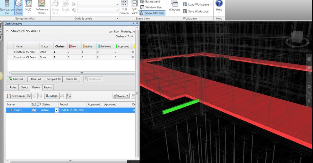

However with the help of my team member @jonathan_moreno we were albe to detect the IFC for clashes in Navisworks
Screenshot below:
Please feel free to reach out to us if you have additional questions. Good luck with your project!
