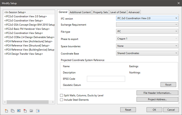

when exporting nwc and ifc files, the coordinates are not transferred correctly, see Figure 1Figure 1Figure 1revitrevitexport_setting_nwcexport_setting_nwcifc_set_1ifc_set_1ifc_set_2ifc_set_2ifc_set_3ifc_set_3ifc_set_4ifc_set_4ifc_set_5ifc_set_5
below are screenshots of the settings, does not work on revit 2021-2023
and link to revit 2021 files
ifc exporter updated to latest version
rvt, nwc, ifc

To make sure this works you have to match your revit project base point.

elements are unloaded from one file!
