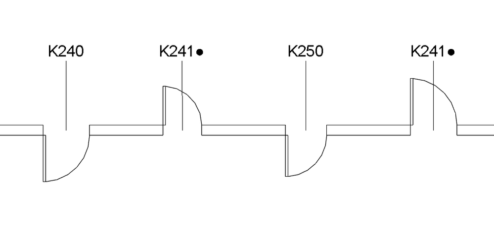

I have approx 3000 doors in our project. I have a Shared-text-parameter called drofus_Entreprisetilhørighet on all doors.
In the proporties palette, that parameter tells us, what contractor the door belongs to. The text paramter will only say K240, K241 or K250.
In my door tag I use that parameter, and the tag will show K240, K241 or K250, no problem there.
My question is:
Is it possible to create a tag, that will create/show a black thick dot every time the door is marked K241 in the text parameter drofus_Entreprisetilhørighet ?
I was thinking about creating a filled region in the family and then make a visibility setting on that filled region, and then create an "IF Statement"
e.g. IF drofus_Entreprisetilhørighet = K241, then the dot will show.
If anyone can clarify if thats possible or not, and berhaps give me some guidence I would be very happy.

So I have a possible solution for you, but it is a bit complex. If you do this kind of work all the time, then it would be worth it, but if this is a "one off" it may not be. Also, I am using a new feature in 2017 here, so if you don't have 2017, this may not work for you either. OK, here goes.
Create some Shared Parameters: (two are <Family Types> and one is a Yes/No)
<Family Types>:Generic Annotations - I called this one "Designation" but you can name whatever you like. This is the one that will be one of your three vales: K240, K241 or K250.
<Family Types>:Generic Annotations - I called this one "Compare" but you can name it whatever you like. This one will be permanently set to K241.
Yes/No - I called this one "Toggle" (Again, name whatever you like).
Create some "Empty" Generic Annotation Families
Create a new annotation family using the Generic Annotation template. Delete the red note and save it as: K241.
Save it again as: K240
Save once more as: K250
All three of these are EMPTY. They have NO geometry in them.
Manually Edit the Shared Parameter File
This step should be done with caution. Make a backup of your shared parameter file before you begin. Open the file in NotePad. It will look something like this:
# This is a Revit shared parameter file.
# Do not edit manually.
*META VERSION MINVERSION
META 2 1
*GROUP ID NAME
GROUP 1 Dimensions
GROUP 2 Data
GROUP 3 Exported Parameters
*PARAM GUID NAME DATATYPE DATACATEGORY GROUP VISIBLE DESCRIPTION USERMODIFIABLE
PARAM 61110ec2-6265-4cad-9e28-2dab8d30dc9c Compare FAMILYTYPE -2000150 2 1 1
PARAM 1e20bff0-a140-4e52-823c-681226dc890e Designation FAMILYTYPE -2000150 2 1 1
PARAM 6a9942fc-406e-443d-8837-2a13420d000b Toggle YESNO 2 1 1
Locate your Compare parameter and at the end of the line, change the 1 to a 0 (zero).
PARAM 61110ec2-6265-4cad-9e28-2dab8d30dc9c Compare FAMILYTYPE -2000150 2 1 0  <----
This makes this parameter "read only" and you will not be able to edit its value. This means that when you add this parameter to a family, it will assign the default value to it and you will not be able to change it. So, careful planning is important here.
Close and save the shared parameter file.
(If you have CTC Express Tools, you can do this step in their Shared Parameter Manager tool and it is a much nicer experience.)
Open your Door Family and add parameters
This is the step I don't like if you have lots of families. If you have an automation tool such at CTC Family Processor, this can go MUCH quicker for lots of families. Otherwise, you  will have to repeat this process on each door family.
In the first door family, Import the K241 generic annotation ONLY. (We will import the others later). This is VERY important to make sure that the un-modifiable parameter gets assigned the correct value.
Notice that the parameter will be grayed out, but it will be assigned to K241.
Add the other two shared parameters to this family as well.
Add a formula to the Toggle parameter: Designation = Compare.
(I made all of these instance, but you can go Type-based if you prefer).
Now you can import in the other two generic annotations.
So what this is doing is giving you a drop-down list in the Designation field. This will list the three loaded generic annotation families. Since you named them K240, K241, and K250, you will get a list of those options. Meanwhile the un-modifiable parameter is also showing generic annotations, but its value is fixed on K241. So this way, a user cannot accidentally change it. This is key, because the formula compares the two fields and if they are the same, it checks the box and if they are different the box is unchecked.
So now we have a checkbox that will drive the "Dot" in the tag.
Unfortunately, you now need to repeat this process in each door family. (Again, CTC Express tools would be a BIG help here).
Edit the Door Tag
Open your door tag next and add a new label.
In the label parameters, use the icon at the bottom to add a new shared parameter to the list. Add ONLY the Toggle parameter (The Yes/No). DO NOT add this Toggle parameter directly to the label. Instead, we will do a calculated value. Calculated values are new in 2017.
Click the Calculated value icon in the middle and give it a name.
Input the following formula:
if(Toggle, "n", " ")
So you are probably wondering why "n". Well, instead of using a filled region and trying to get it to turn on and off, use a font! In the Webdings font (installed in most Windows systems), the letter "n" (lowercase) is a solid filled black dot!
Close the dialog, save the tag family and load it and your modified door families into your project to try it out.
Test it out
In your project, select any door and you should have a drop-down list on the properties palette of any door you select. You can choose one of the three designations there. If you choose K241, the black dot will appear on the tag.
Tag the doors to test it out.
Whew. That is a lot of steps. And as I said, might be overkill for some projects. But since you said you have 3000 doors, I figured it might be worth a shot.
I attached a sample file.
Hope that helps.
