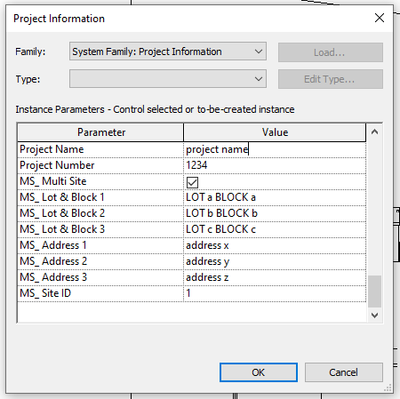

Thanks for everyone's input! Very interesting, I will have to play with linking different site models w/ project info into separate worksets into a single Revit file that contains the building & documentation. It sounds like the result I would desire, and I'm hoping it does when I try it on a more complex job.
I ended up doing here something much less proper... This is a job with a low budget: a storage building. The goal is to do it down and dirty (but with clean results :D) and the least amount of stuff to manage and/or set up. Also, I expect a few revisions down the line after CDs are issued, which would be applied to all of the buildings.
Here is what I did:
Created a Project Parameter called MS_ Site ID which can be set to 1, 2 or 3. this is a toggle for which address Revit project will use. Then I made project parameters MS_ Address 1, MS_ Address 2, and MS_ Address 3. These hold the address of each site. (I also made a project parameter for each Lot and Block, which is the only other information that varied across the jobs)
Then I made a Dynamo script, which can be executed via Dynamo player. It looks for MS_ Site ID value, and based of that sets the project's address. Simplified version is pasted at bottom of the post.
The grade level ended up not mattering as much as I thought. In our standards, the ground level is always set to 0'-0" and we have a note that tells you 0'-0" on Architecturals points you to x'-x" on Civil ...
This job is so simple, I am not modeling the topography, but I will still sketch a semi-accurate grade line on elevations using filled regions. The regions will have a pre-fix in the name which dynamo will read and show / hide based of that. And whatever will deviate at each address (there shouldnt be any deviations, I will just add use another prefix and have dynamo adjust visibility based off address)
