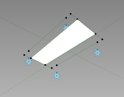

Basically the title says it all, i am creating a 4 points adaptive family where i want the surface to offset from those points in the Z axis and also most importantly outside the border of those points in the Y or X axis, here is a picture explaining exactly the offset.
Z axis offset is easily done and internal offset is easily done, but i want the offset outside the border of those 4 points.

Sounds like you want to host Ref. Points to other Ref. Points and drive those RPs offsets from their host RP parametrically.   Are you familiar with what I'm talking about?

Yes, the issue is with hosting actually, i have tried several ways to host those points over other points, but there is always an issue with that because its outside the square of the adaptive points. Check images below (A1) if ref point are hosted on XY plane of adaptive 1 and 2, when pt 2 moves upwards the hosted point will stay in XY plane of the latter. Yet i want that ref point to move on the same ref line connecting adaptive point 3 with 2 (PIC A2)

You need 3 points at each adaptive point in order to offset x y z from it.  The last points of the 3s define the surface corners.

Host point 1a on XY plane of adaptive point 1, offset.  Host point 1b on XZ plane of point 1a, offset.  Host point 1c on YZ plane of point 1b, offset.  Repeat at all 4 adaptive points.  Use 1c, 2c, 3c, 4c to create the boundary lines of the surface.

I hosted 1a on XY AD PT 1 - then 1b on ZX 1a - then 1c on ZY 1b
All the points move with XY AD PT 1 - i want 1c to be on ref line of (AD PT pt 4 and ref PT 1a)
Do you get my point ? I think @barthbradley got what i meant

Yes i know its a mess, I have attached a new clear family, to simplify everything. I will ask the question in a clear and straight way. I want ref pt 1c to be on the ref line connecting AD pt 4 and ref pt 1a when you are looking at the model from left side view. (picture d2 attached) if this is solved i'm pretty sure i will figure out the rest

Issue here is the same that i am facing. Please check pic E2 the offset X that i will place as a parameter, will not be the actual offset which is Y marked in the pic

So you want it to be like this?
