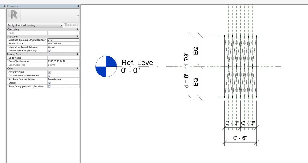

I am in the process of building a template for our "I-Joist Layout Guy" in Revit. He is still using software that runs on Windows XP and we have been trying to get him to join the new millennium for a while now. I need this to be as simple and "plug-and-play" as possible. He just needs to be able to select the family that the print calls for and input it, and Revit does the rest.
I'm sorry if I'm being difficult with you guys. This is frustrating me to no end. All I need, is to find a way for Revit to draw in 1-ply (which it does fine), 2-ply, 3-ply, and 4-ply LVLs, while also giving me a "count" for each LVL in the project. Like I said, I can manually draw in each LVL and get my count just fine, but when I get to a house or building with 20+ multi-ply LVLs that is going to become very time consuming.
Here are some pictures of what I am working with.
This is what I have been trying to work with. Beams 1 and 2 (moving form top to bottom) are a single LVL that I copied and pasted next to itself. (see next picture) the 3rd beam is just a single LVL. The 4th beam (Second single ply) is from a multi-ply family that came with a plug in called VisionRez. As are the next 3 sets of LVLs.This is what I have been trying to work with. Beams 1 and 2 (moving form top to bottom) are a single LVL that I copied and pasted next to itself. (see next picture) the 3rd beam is just a single LVL. The 4th beam (Second single ply) is from a multi-ply family that came with a plug in called VisionRez. As are the next 3 sets of LVLs.This is the top 2 beams in the first picture. As you can see, I copied the original LVL and slid it next to itself. This isn't what I want.This is the top 2 beams in the first picture. As you can see, I copied the original LVL and slid it next to itself. This isn't what I want.This is what the multi-ply family looks likeThis is what the multi-ply family looks likeThis is also the multi-ply familyThis is also the multi-ply familyAnd finally, this is what the properties look like for that multi-ply family.And finally, this is what the properties look like for that multi-ply family.

That is because the default 'b' and 'd' in the family are not shared parameters.  I am uploading a screencast showing the steps.  It's quite simple actually.  It should be up in a few minutes.
https://knowledge.autodesk.com/community/screencast/5f27d002-0a84-4080-860b-1850e6ca7734
