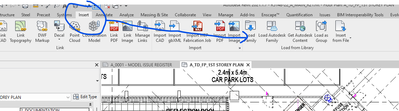

here

Nachricht 4 von 9
turbobeast
als Antwort auf: ennujozlagam
Thank you! I hadn't ever seen that before this release. I was able to find all the tags under Annotations in this location.

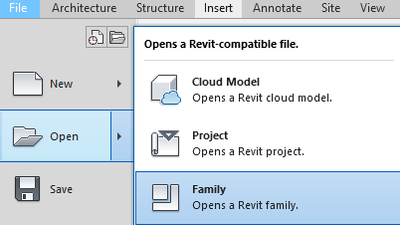

2023:
I just tested this and it worked by using load family it went to my library
when I use load Autodesk Family it takes me to the cloud system (as that one has a cloud)
I think the Load Family should load something in your library, where as the load Autodesk with the cloud is loading off the Autodesk cloud:
above off the library on your hard drive
above has the cloud so its going to the cloud:
this route is does not show an option except to open the family:
my usual method above only gets me to my library on the hard drive
