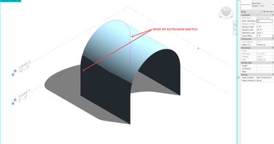

I'm a beginner to Revit. I have to recreate this :
Just a simple greenhouse in the backyard of the company where I work.
What is the best way to recreate this?

No, they aren't needed. I mostly want to respect the shape of the greenhouse, so straight walls with a round roof, a bit of transparency just like in the picture and maybe the metal tubing frame of the greenhouse. I don't need a masterpiece, we're just trying to recreate the backyard for future planning of the space we have.

If you just want to have some fun and create something that is a near-approximation; then use the Roof by Extrusion Tool with a very thin Roof Type.  That's one way to "skin the cat", so to speak.
...oops. forgot the very thin wall.

This is what I would do, and understand I don't know what you are building the model for, I just know you want to model this green house.
1. Create a wall that will work as a translucent material.
2. Create a roof type with similar properties.
3. Draw your walls using a simple rectangle the size of the greenhouse. Use Level 1 to Level 1 TOP for example, and from the look of it, these two levels need to be about 0,0 to 3'-6".
4. Create a section of the front of your greenhouse, and then create a Reference Plane right at the front of that green house on the exterior of the wall.
5. Now go to your elevation view you created by double clicking on the view bubble that shows the "--" because it hasn't been placed on a sheet.
6. Draw a model line arch, or half circle from the top of the wall on one side to the top of the wall on the other side, then picking the outer quadrant, making sure it's a half circle which it will snap to. If it wants you to pick a plane, pick the one you just created for that arc.
7. Create a roof using the extrusion option, and select that line you just drew as the extrusion line.
8. Make sure the walls attach to the roof.
9. Either model lumber or create a wall that has a solid core of wood for the base.
10. You now have a simple greenhouse you can see through!
There are TONS of ways to get this one, this is just one of them. Hope it helps.

Thank you! It worked :leicht_lächelndes_Gesicht:
