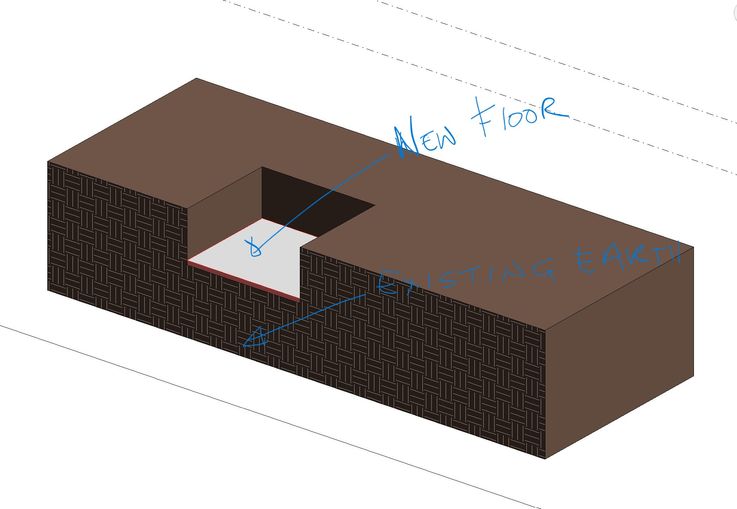

So I just don't get grading at all....
My graphical representations constraints are red for construction and yellow for demolition.
When I grade my scope of works site I get a completely demoed part and a completely new part, which represents as such :
This is makes no sense to me...
When I then excavate with a floorand show previous+new I get my new floor in red, and all the ground under in red, as it is considered new...
But obviously it is not new earth under the floor...
Now if I show previous+demo I get all the topo demoed, which again is ridiculous as I just want the excavated part to be demoed
The acurate representation of the situation should be for previous+new :
previous+demo :
Is it just me?
