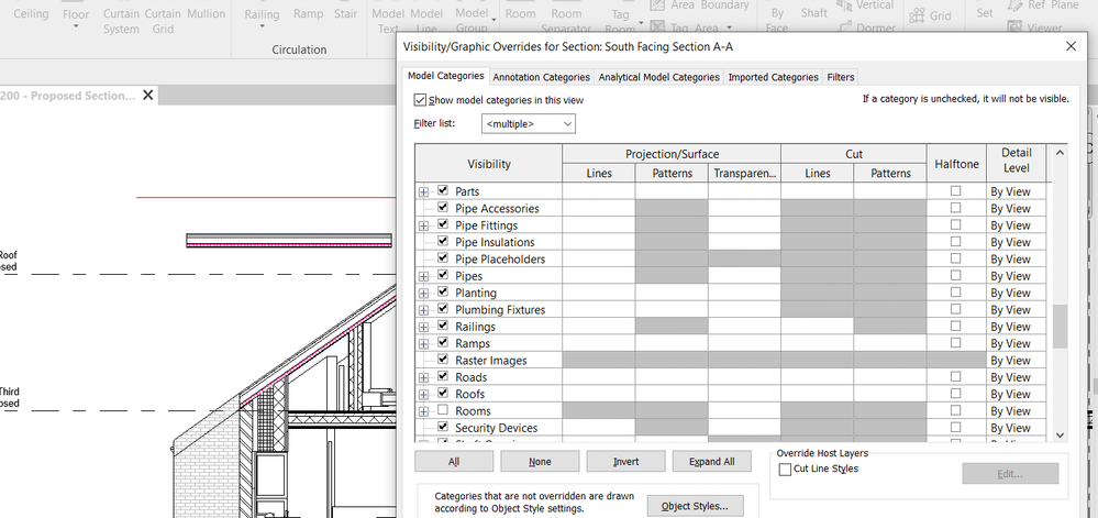

Hello
I'm working in REVIT 2022 full and have a template set up for fine detail while I'm drafting my views.
My floor and wall types are showing up perfectly with the makeup of the element, however my roofs are showing as a solid black fill.
I have check that there's no overrides in the template and that roofs are set to 'fine' but I don't seem to be able to get to the bottom of the issue. Any ideas?
Excuse the junky model - It's a work in progress

Nachricht 2 von 18
syman2000
als Antwort auf: Anonymous
Can you check in the filter to see if there is filter set roof to cut set to solid black.

Nachricht 11 von 18
als Antwort auf: syman2000
Well that's frustrating - If I copy a little of the model to another file it SHOWS so I must have something set incorrectly in the project. I've deleted out most of the project but the view I'm referring to is Section AA

Nachricht 14 von 18
syman2000
When I look at the view, seems like it has solid fill applied and set to course. I removed it and it works. I double click to access the view and then use VV shortcut to make it show.

Nachricht 16 von 18
syman2000
Did you double click into the view? Sheet also has it's own visibility and graphics but that won't fix the problem. So you select the view and right click to activate view. You should see the titleblock being greyed out. Then do VV shortcut and you should be seeing the setting where roof is has solid black cut and set to course.
