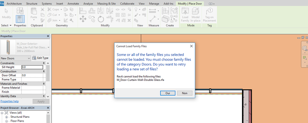

I can't download a door from library.
I am trying to put a M-Door-curtain-Wall-double-storefront, but an advertisment message appears tells me that I cannot load family file !!
How could I fix this issue ?
Thank you.

Open the .rfa and make sure the family is a door type.family type.JPGdoor family.JPG

Looks like that is a curtain wall door - that is a different animal. You will need to create a curtain wall and then drop the door into that.
Look at this for more details -
https://learning-revit.com/adding-a-door-to-curtain-wall/

Hi @abidlihouda
@Sahay_R is right -  first, create a curtain wall and then you can add a door to a curtain wall by customizing a curtain panel so that it schedules as a door.
See similar thread here
Let me know if this helps and if you have additional questions!

@Sahay_R,
Yes it's a curtain wall. Your solution works very well ! This is what I needed to figure out.
