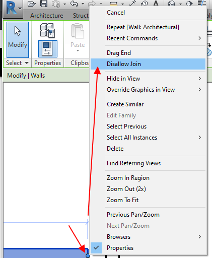

When drawing an interior wall how to stop it from extending to another wall`s structure line instead of just ending the wall where I click the end point to be? See image please. Does anyone have an idea how to solve this?

Click on the Wall that you do not want to connect, then click on the blue point with the right button of the mouse and from contextual menu that appears check Disallow Join option

I forgot to add the screen capture....

After activating the wallplace command, but before you start placing the wall set join status to disallow.
Join status wallJoin status wall
