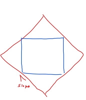

als Antwort auf: dcsank
Create a bigger roof rotated 45 degree with one way slope, enter this formula to the slope =5*pi()/180*sqrt(2) , then use a vertical opening to cut it to shape.

I made exactly what I want in terms of sloping in a roof using simple trigonometry for inputs for the points below but this can't be changed to a slope glazing type. So now I need a formula that can do this to use as slope within the footprint edit tool

Saw your replies and then realized this thread is almost exactly a year old :leicht_lächelndes_Gesicht: I was thinking the same thing with a slope arrow. I just experimented with slope values until the slope annotation reported 5 degrees (really 4.96 but rounded off). For a rectangular roof (not square) we'd just have to calculate the fall for each side that "mattered" and then plot out the slope arrow in the direction the roof would "fall". A bit tedious but doable.
