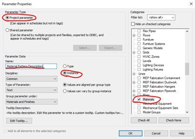

I thought of some ways to schedule some things like this. You are able to add a project instance parameter under materials which you edit within your material settings. You can manually match the pattern description for your materials applied and schedule that.
Another similar method I could think of would be to schedule ie. a sort of (unique) Material marker parameter the same way as above in the project. Then use a calculated parameter to check the (number) value and return a pattern description belonging to the Materials properties (also manual input). Something along the lines of ... if(Material: Material Marker = 100, "InputPatternDescriptionHere", "")  Those would ofcourse have to be unique values though.
Both are not automated though, both require user input (!input errors). Something to be said for Dynamo here probably...
