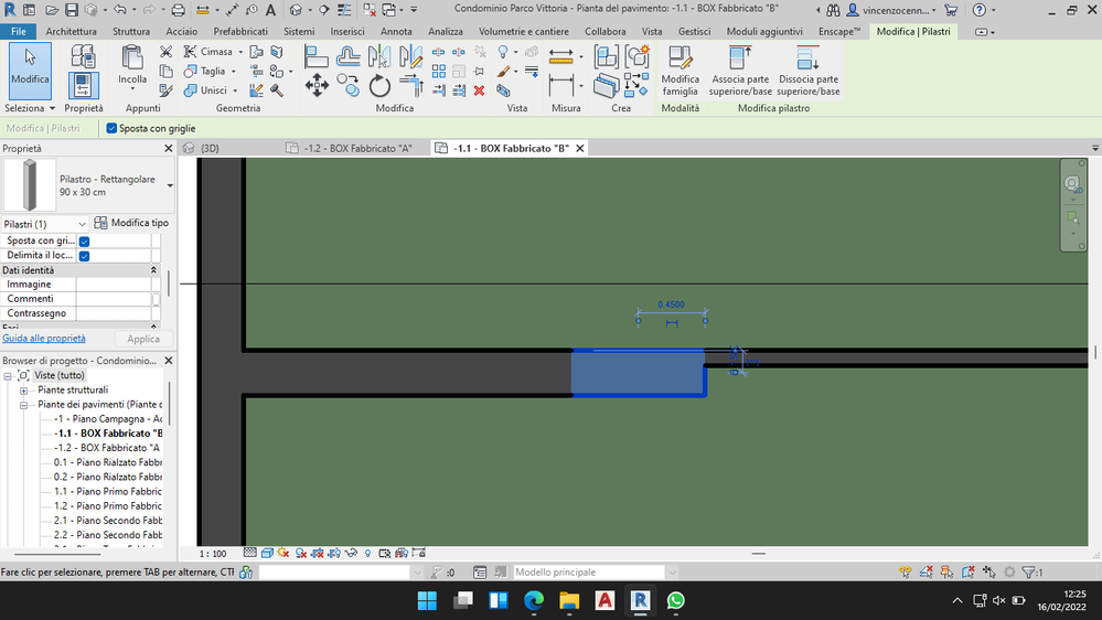

This is my first question here on this forum; I hope you can help me with a visualization problem. I need to have thick lines that show where is the separtion between a wall and an architecural column. How is this done? i tried everything I know about visualization and it didn't work...

View Detail Level should be: Medium or Fine
Go to Modify >> Join Geometry: Switch Join Order
