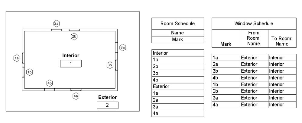

@SteveKStafford wrote:
@ToanDN  What are you considering the interior side of a window? In the stock families, the From Room values for a window report the interior side of the window family. If I flip the geometry of the family then the interior side is the outside of the building for an exterior wall or a corridor instead of a room.
I am considering the interior side is the side of the room that reports the windows when I create a Room schedule with an embedded window schedule.  The From Room and To Room information from a Window schedule are rather irrelevant because they can swap on the schedule without even flipping the window physically on plan.
In the example below, if I would like the (a) windows to be included in the Room schedule and remain on the exterior side of the wall, the only way is to edit the family and flip it.  Changing From Room/ To Room, or changing the Room Location arrow, doesn't help.
p/s: the experiment was from answering another users.  I myself do not schedule windows using Room location.

SteveKStafford
als Antwort auf: ToanDN
Interesting. I get that result from the stock windows without doing anything to them.
