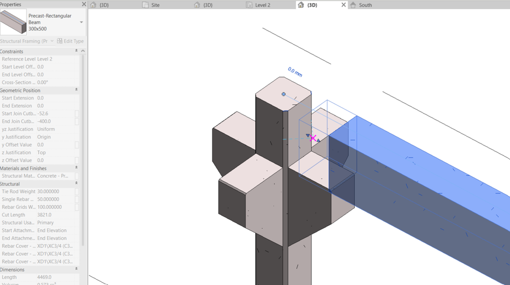

Disallow join the beam and grip stretch it manually.

I would try loading in a precast beam, that will give you the end shape handles.

There I go, overcomplicating again. Thanks!
