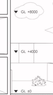

I am curious, is there a way to remove the Horizontal Line from Levels on Elevation View? I would like to retain the Arrow Symbols, just not the Horizontal Lines. I tried moving the Horizontal Line as close to the Arrow Symbol as possible but it still doesn't remove the Horizontal Line.
Example for what I tried and didn't succeed:
Example of what I want to achieve:
Anyone know if it's possible please?

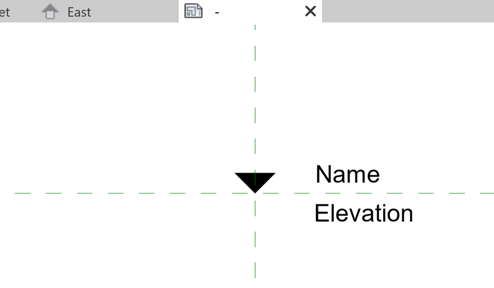

Hey,
I don't think you can get rid of them completely, but I had a quick play with the family and the line patterns to get something a bit closer? Maybe you get improve it with some more time...
Hope that helps,
Mark

I just drag the tip of the line towards the head.  Make it really short.  But I don't have heads like yours, so I can see where that approach would leave the short segment visible in the View.   Maybe override the color of that remaining short line segment in the View and make it white?
