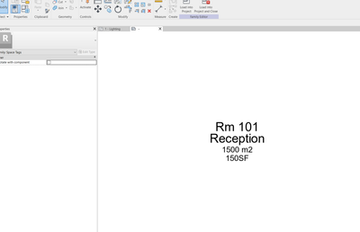

I want the room tag base point to be at the centre of the text rather than at the bottom. This is because where I drag a tag to the bottom corner of a small room to fit it in, it moves outside the room boundary, making it invalid.
I've searched through forums where one solution suggested creating invisible lines at the top and bottom of the family. Unfortunately this didn't work.
Any help would be appreciated!
(see screenshots as attached)

You need to go to VGO's and turn on the Reference Subcategory under Rooms and then you can grab the origin and move it.
Nachricht 9 von 29
RSomppi
als Antwort auf: owen_bentley
Edit the family and move the objects within the family so that they are centered on the origin.

I've moved the points but I'm still getting the same issue.
Nachricht 11 von 29
owen_bentley
als Antwort auf: RSomppi
Thank you, this has worked!
Is there no way to change the origin point of the family? The project has a fair amount of rooms so it would save having to move all the tags.

When I drag my room tag to the corner of one of my small rooms, revit doesn't recognise that it still sits within that room's boundary. This is something to do with the fact that the room tag's 'origin' point seems to be sitting below the lines of text.
I have solved this issue simply by moving the text within the family downwards as per @RSomppi suggestion.
However, I'm looking to see if there is a way to move the actual origin point to save moving all of the room tags which have already been placed

There aren't reference lines existing within the family.
I tried creating some, but to no avail. It still seems to be dictated by this invisible origin point.
Yes, there are. You have them turned off in the visibility settings V/G Overrides.

Thanks, please see attached for the annotation family.
I've played around with the reference plane and there doesn't seem to be a correlation with it's room bounding origin point.

This Tag Family is fine.  You don't need to mess with it.
Post the RVT (Project) that you're having issues with.
