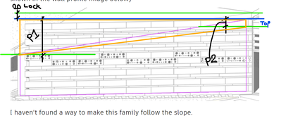

Last thing tho, I'm using the family you shared and I'd like to apply the same concept to the top portion, but I'm facing a challenge: my wall has a slight slope (as shown in the wall profile image below)
I haven't found a way to make this family follow the slope.
Currently, I'm attempting to place a void blend at the top of my family and make it parametric, though I'm unsure if this is possible. Ideally, I'd like to be able to specify the void height on both sides of the wall within my project.
Is this the best way to achive this?
Regarding your question:
"what is expected happen when the wall or panel height or width is increased by say 1 meter?"
Ideally it should generate more tiles vertically and horizontally, but I dont encounter this cases, if I need more tiles i just place a new instance of the family.
Message 4 of 10
RDAOU
@edoardo_balducci
A blend? its an extrusion make the void trapizoidal with adjustable height on each side
You need 1 reference plan and 2 reference lines or 3 reference planes (assuming u use the latter
  1. Place one plane above the wall top and lock it to the ref plane wall top
  2. the other two ref planes place below and associate with a parameter to adjust the depth ot the trapizoid on each side
I already left the office so I cannot re-edit the family for you but thats is how it will look like
  • Green are the new reference planes to add
  • Blue is the reference plane already there at the top of the wall
  • Orange is the trapizoidal extrusion
  • If you adjust P1 (a parameter Length - Instance) => it adjusts the left side
  • If you adjust P2 (a parameter Length - Instance) => it adjusts the Right side (Make this 0 and it will align to the corner of the wall as you sketched it
