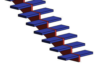

how to make stair middle suport
how to make stair middle support under the thread/step. thank you.

That is already a middle support. My question is how to make the middle support to be underside of the steps. Thanks

Use a carriage type for the mid suppport.
Nachricht 5 von 14
als Antwort auf: BIM_Dreamer
Look to me like the Tread Profile is the problem (e.g. drawn incorrectly in relationship the Origin Ref. Plane).  Does it happen like this when you use the Default Profile?

Does your screenshot depict what you are trying to achieve? Looks like you want the top of stringer on the same plane as the top of the treads.  In other words, the treads would be fastened to the side of the stringer as shown.

managed to get the stringer to underside of steps by editing the tread profile moving above the reference line. thank you

The top of tread profile is on the reference line. The tread thickness under the stair run configuration is set to equal to the height of the tread profile. The carriage will match to the bottom the treads automatically.

don't mind to show me where is it, because right not now the stringer and steps don't align each other i have still 1mm gap. thanks
