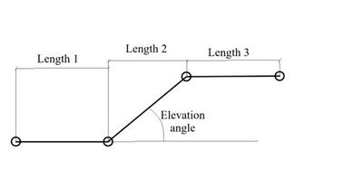

Can someone explain how to make conveyor in revit like the one shown in attachments but with one more horizontal part at the end of elevation and adjustable by the Length 1,2,3 and elevation angle (i attached a scheme of such conveyor). I haven't found any similar instructions on the internet.

There are several ways to built this. Easiest would be to built with family. See attached

The angle is in the instance parameter and it is controlling the height.
As for the family how it was built, it is based on the simple diagram you've provided. The Height is determined by angle and length given and using tangent formula to drive the height parameter.
The rest I built with sweep profile and extrusion.
If you want to determine the height, then you have to remove the angle and the formula. This will allows you to adjust the height manually. See attached.

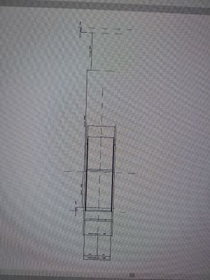

Thank you so much, i spent 4 hours today but finally made it. I struggled a bit with rounding radius of the conveyor belt. So i had to make it a bit complicated than you did. It looks kind of broken on the ref. level (see attached photo). But it seems working. I attached my file maybe you will be able to take a look at it and point out some mistakes. Thank you again.

Oh, thank you so much. I'll try this method tomorrow because the one i built with previous instructions looks broken on the reference level whenever i change the elevation angle (You can see what it looks like on my post from ‎08-21-2023 09:47 AM there is a file attached as well). Maybe you know what's wrong with it? Here is an example with just a straight conveyor put on the plane. So i change the angle of the planes to make it inclined. When angle is 0° it looks fine (Figure 1). When i change the angle it looks cropped(Figure 2).
