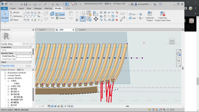

I posted previously  the same question but made propromise before, but now cannot avoid that, so sorry I have to repost it and make it solved now:
There is a vertically curved adaptive object , its face has vertically curved face, meanwhile its 3 sides points has to be adopted. (some like a twistable suspension, but they are repated production componens).
I made this vertical curve but it extrude horizontally (i think this curve is deems on a vertical workplane so it extrude horizontally).
I tried many ways and search many tutorials but no solution found (a vertically curved face with 4 sides adaptive)
Please advice Thanks

This is the side elevation.
 Then the end is requested not vertical. but should follow another edge curve

If you set the profile to always vertical, you might be able to loft it; however, when flexing and if the curvature is nasty compared to the thickness of the profile, Revit will throw at you the error "Unable to create form" or "Form self intersects"
If you want a vertical cut at the ends, you have 2 options
  1. Either Loft the profile along the curve then cut it with voids hosted at the end/placement nodes
  2. OR (Instead of lofting a profile along the curve)
    • Use a 1 Point adaptive family for the profile - Global Z then Host xy (nested)
    • Divide the curve
    • Host the adaptive profile on 1 point
    • Use repeaters
    • Break >> select all >> create form
Apart from the above... I am curious, why 3 adaptive placement points? if that is intended to twist/twirl the planks of that foot bridge, it wont work.

And this post is for vertical joists with gap between, see below picture (except that the end face is still vertical which is not what is requested to tweist along with the edge curve)
Yes it is tricky request from 3D printing team (a workshop to print the whole building not just a component). and Revit are almost aooriaching  the ultimate target... I had tried other sotware eg ARCD etc but halt at mid way...

So the only vertical are the 2 end faces? If so, just create a normal adaptive sweep with 3 adaptive points, then place 2 vertical voids to cut the ends.

How about these?  They are identical except for the end faces.

BTW could you show how to place the 9 APs in the malify grid?

Turn on Nodes.
I use 9 points so that the Repeater can place the beam with a gap.
There was some error after Repeater so I has to remove the faulty ones, placed a beam on the other end and repeat again, then deleted a few overlapping.  The error is dependant on the curvature of the surface so you may or may not get it.
Nachricht 16 von 18
als Antwort auf: heichan88
You only need 7 adative points, 6 to drive the geometry of the beam and 1 to create the gap.  9 as Shown earlier is unnecessary.
