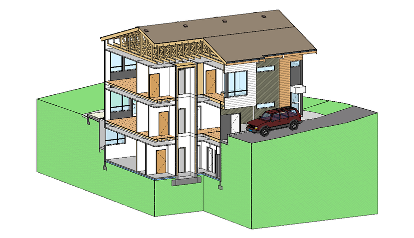

Basically the title says what I am trying to do. Instead of having just one section box I am trying to use two section boxes in one 3D perspective, but can't figure out how in Revit. I'll attach a picture just for clarity's sake. My terribly drawn blue line is where I would like the other section box.

You have to create two separate 3d view. One cut one side and the other cut the other side. Once you have to them both cut, you merge it in the sheet view.

There is no native tool in the program to do this, but you can do that, for that you will need to duplicate a 3D view and overlay them, and create a section box for each view. Watch this video.
https://autode.sk/2FVHBDq
It looks better in realistic style because of the edges.
