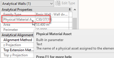

Nachricht 7 von 11

Nachricht 10 von 11
anze.kumar
als Antwort auf: ConstantineC
Yes, only a full wall can be set as Structural and the visible in Analytical.
Structure property in the  composite wall layering then dictates which material does the revit take to be the structural.
As far as I know, Revit does "know" that this Analytical wall has a structure of one structural layer and takes the appropriate material for analysis for Analytical wall - as far as you have the appropriate physical assests set in Material dialog
