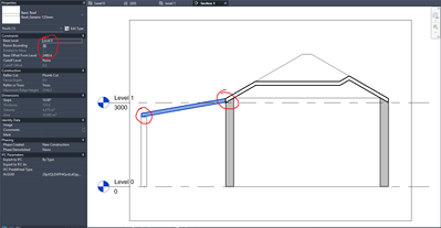

You need to change the base offset of the verandah roof. It's currently the same as the main roof which means that the top of the verandah roof is higher than the base of the main roof. Cut a section through the building and move the verandah roof down to match the main roof.

I don't understand too well with the sections. Is it possible to see this in a 3d view?
Nachricht 6 von 10
Lachlan-JWP
als Antwort auf: parkslanden183
Here is the same thing with 3D views.
Both roofs have the same Base Offset:
The verandah roof has been moved down so that the top matches the base of the main roof:

How do you align your roofs together to joint? I can't get the offset right.

It's easiest to do in a section view. You can just move the roof down to the height you want.
