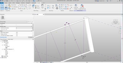

I'm trying to create a strap that loops around 2 metal rodes for a table. I created the path with straight reference lines and spline through points in massing environment. I want to join the the two for a continuous path. is that possible? or should I create this element in a different way? Thank you

If the endpoints of the spline are connected to endpoints of reference lines, the path is connected already.
