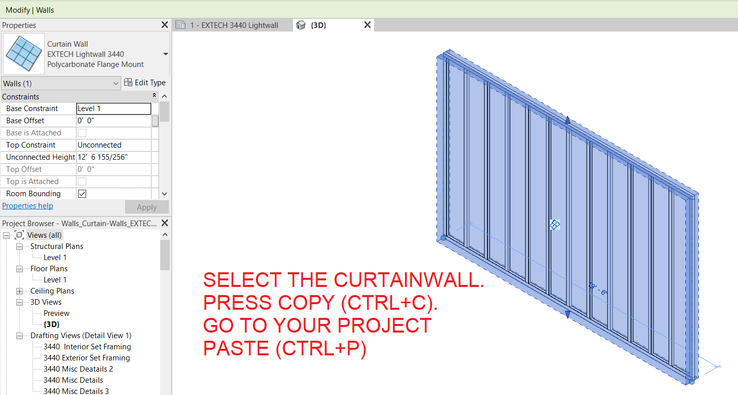

syman2000
Go to the 3d and copy the curtainwall style and paste it into your project.
