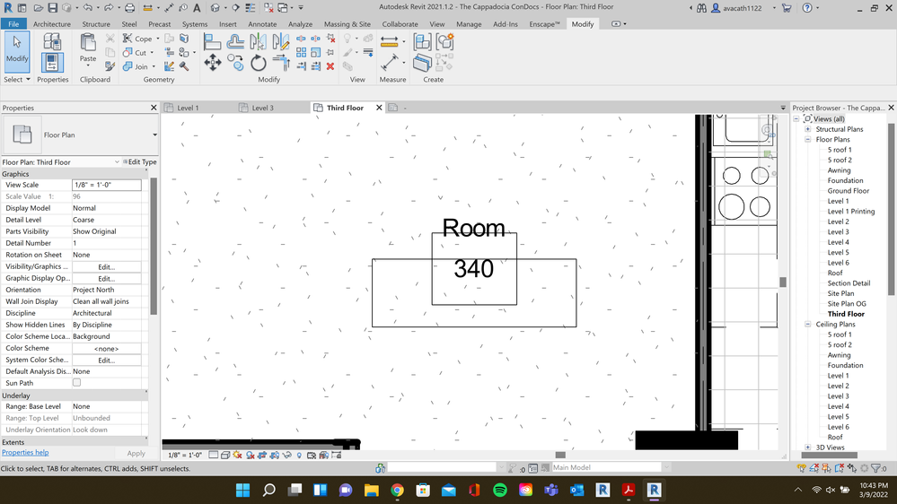

This large border won't go away on my room tags. I've tried editing the family but it's not showing up.

Edit family, VG, annotation tab, tick boxes, then you can see the lines to delete or change to invisible.

yeah, that's  not right. Nothing is checked under annotation and the box is still there
