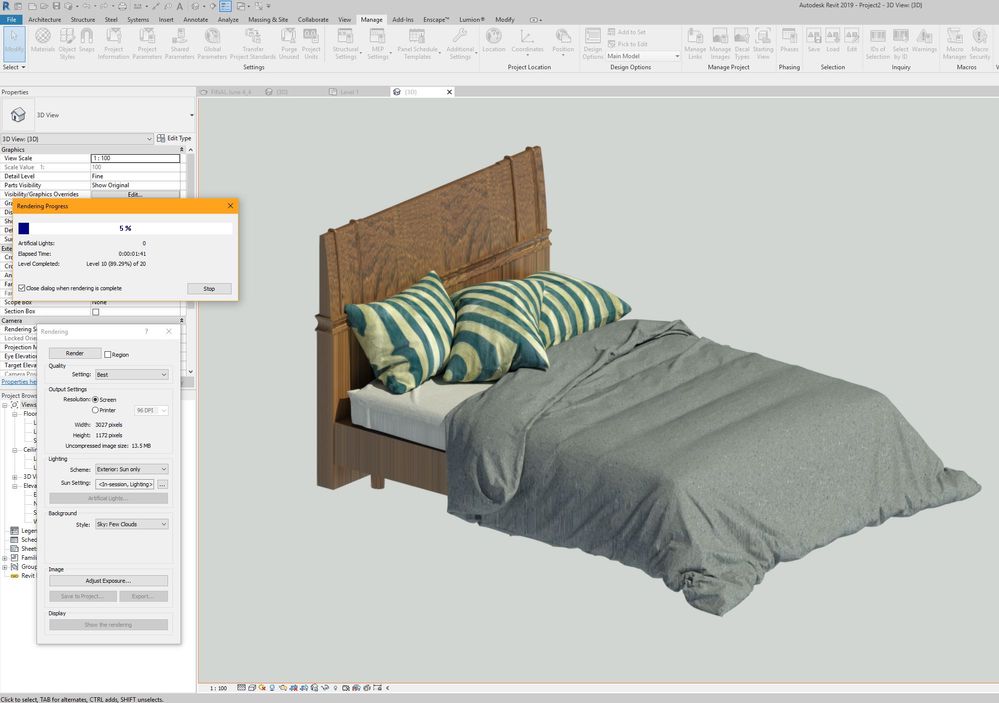

... this bed was made in sketchup
... then exported as a dwg
(to do that you need to separate all elements in different dwg and apply same material for each one)
... then create a family in REVIT
... look how good it renders in REVIT
... to me is almost perfect
